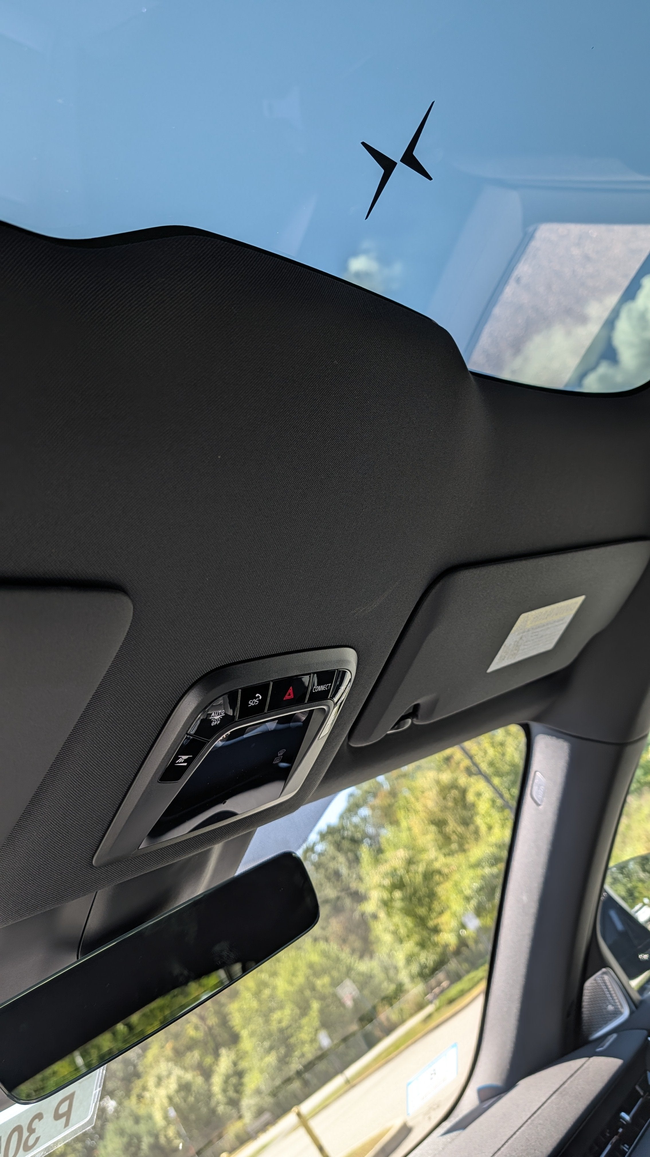

New loaner swapped to me because they've sold my existing loaner. This loaner is brand new with 300 miles, and is a June '25 build. Digital key won't initialize, which it easily did when I had to do it twice on the previous loaner.
It also has something I've not seen on another P3, other than the etched version on some very early Launch Editions. It has a Polestar logo in the sunroof! And it's legit sandwiched in the glass and not some decal applied on the inside or outside.
Does it light up?
