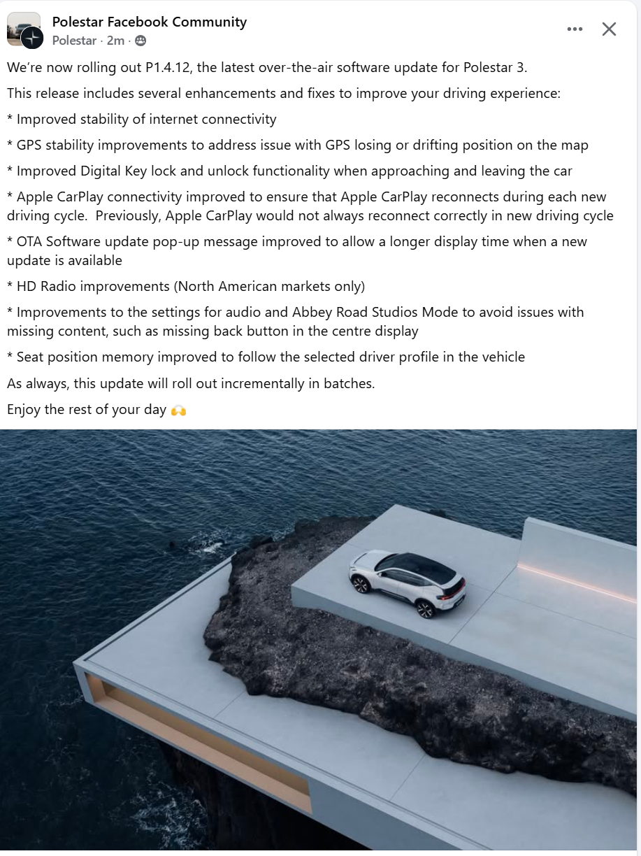

The update was announced on Oct 7 and released to workshops first. As of Oct 10, no one has yet reported OTA availability.
Updates in Software Version P1.4.12
  • Fix for seat position so that it is now correctly connected to the selected driver profile.
  • Solution for performance issues related to third-party HD video streaming apps.
  • Audio and Abbey Road Studios Mode settings are fixed to avoid issues with missing content, such as missing back button in the center display.
  • The pop-up message for OTA Software updates now remains visible for a longer duration when a new update is available.
  • Stability of internet connectivity has been improved, along with enhancements to how the vehicle manages temporary connection loss.
  • GPS reliability has been improved to help prevent signal loss and drifting on the map.
  • Improvements to digital key unlocking functionality when approaching the vehicle.
  • HD radio improvements.
  • Apple CarPlay connectivity improved to more reliably reconnect during the next driving cycle. Previously, Apple CarPlay would not always reconnect as expected.
Direct Link (US Version): Polestar Release Notes
Direct Link (US Version): Volvo Release Notes
